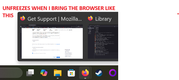

It is a strange freeze though - the whole browser becomes VISUALLY unresponsive, but if I click blindly, say to close the tab or if I scroll up or down it appears to work. How do I know? Well, if I drag the mouse to the bottom of the taskbar in Windows and bring up the thumbnail... It unfreezes the browser - showing the changes I made blindly, at least until it freezes again when the MPEG-4 files start playing again. The freezes are not temporary either - I need to unfreeze through this thumbnail method I described above - otherwise it stays frozen.

Attached screenshots
